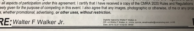

    While processing 2020 License Renewal Applications we have found a number of issues centered around this years inclusion of electronic signatures.
    1) Improper Electronic Signatures:
    Per the instructions on page 1 of the 2020 Competition License Application and the 2020 Non-Competition License Application.
    9. Sign and date the License Application and the Emergency Contact Form. ‘Electronic’ signatures are allowed using the signature function in Adobe Acrobat Reader. Cut and paste signatures will not be accepted.
    This means that the electronic signature function in Adobe Acrobat Reader MUST be used. No other type of electronic signature will be accepted.
    The Adobe Acrobat Reader validation information MUST appear in the signature field along with the signature.
    Example of Signature with Validation Information:
    To use this function on in this years Fillable 2020 License Applications Adobe Acrobat Reader must be downloaded and installed on the computer used to complete the 2020 License Applications.
    A link to the Adobe Acrobat Reader download page is included in the instructions on page 1 of the 2020 License Applications.

    Everyone that I have spoken with this morning has had the same issue.
    TO USE THE ELECTRONIC SIGNATURE FUNCTION ON THIS YEARS FILLABLE FORMS YOU MUST USE ADOBE ACROBAT READER!
    ADOBE ACROBAT READER MUST BE SET AS THE DEFALT APPLICATION FOR HANDLING PDF FILES!
    If you are using ADOBE ACROBAT READER the forms will look like this:
    Blue shaded fillable fields will be outlined in red.
    The signature fields will have a small red arrow in the upper left hand corner with the word signature.
    If your forms DO NOT appear like the above example then you either do not have ADOBE ACROBAT READER installed or it is not set as the default application for handling PDF files.
    ADOBE ACROBAT READER is a FREE download.
    If all else fails simply print the forms and fill and sign by hand scan and Email.
    We have also received a number of forms in JPEG (photo) format. Please sent completed forms in PDF format only!!

    After banging my head on Adobe Reader for a bit, I now have a properly signed document to submit. The nuance I struggled with is the difference between an electronic signature and a digital signature. By CMRA policy, we must use a digital signature, which must be configured in Adobe Acrobat if you want your name to appear, which I assume is required and was certainly confusing when it didn't appear; it doesn't just work, at least to the degree the electronic signature does.
    Digital Signatures - https://acrobat.adobe.com/us/en/sign...signature.html
    For Electronic Signatures, scroll to the bottom of that page and follow the link to information about them. There's a handy video that contrasts Digital Signatures and Electronic Signatures.
    EDIT: to be more direct but still in a respectful, constructive manner, the process of setting up a digital signature isn't intuitive and the seemingly explicit instructions at the top could be improved for clarity. "Electronic signature" should be changed to "digital signature, and I provided a link above (and below) that would ideally be included in any instructions.
    Something more explicit to understand creating your digital signature - https://www.dfa.cornell.edu/sites/de...signatures.pdf
