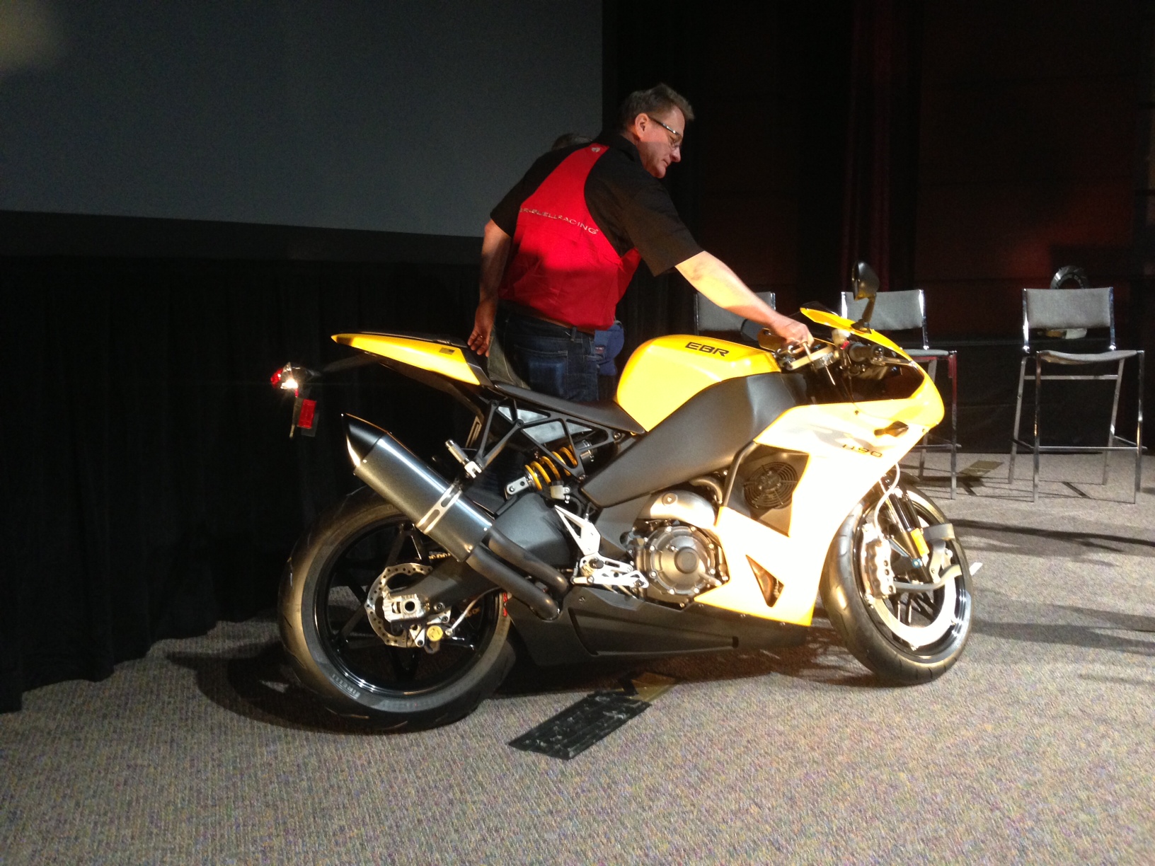

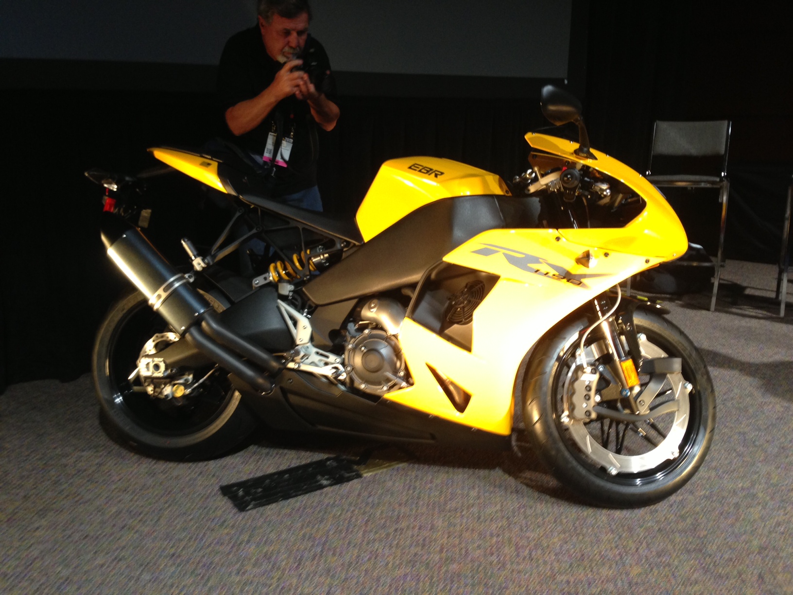

The rotors on the EBR system lose their "bite" over time. Servicing them with some 100-grit helps (as is also the case with 2 disc systems), but yes, they wear out more quickly than 2 disc systems do. Rotors are definitely consumables on the EBR system when used in racing applications.
If you are willing to pay a weight penalty, you can get 6mm rotors that last longer. I don't like them; they make the bike harder to turn.
The EBR system is lighter than most dual-disc set-ups by 2-4 pounds. I'm not convinced, however, that once spinning at 60 mph they have less gyroscopic resistance to directional changes than do traditional designs. I'm not sure how to test it, though.
Also worth considering: Your SV carries more cornerspeed, weighs less, and needs to slow less for each corner than my 1125r. So, your demands for braking are also less.
